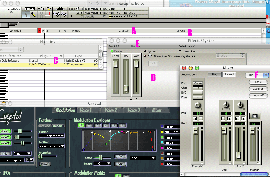

The picture may look a mess but I am trying to get a lot of information across in one go.......so see if you can match it in the metro demo.
(I assume you have some VSTi's already available from using logic).
When metro launches go into the graphic editor window (Command J) and you may see a pretty much standard looking audio type track.
If so, click on the popup at "A" and set it to a 'Internal' output so it sets itself as a midi track (should bring up a piano roll on the left hand side). You can then place VSTi's on the track with the Synth popup at "B".
You could also add VSTi's by opening up the plugins and effects/synths windows (Command 9 and Command Zero).
Drag a plugin from "C" to area "D". The EDIT button above "D" will bring up the graphical window of the particular plugin. This is also accessible from the Windows Menu at the bottom.
How to set a effect/instrument on an AUX.
Go to the SPECIAL menu and select Modify Outputs and Busses
Allocate some AUX Busses at the bottom of the dialog box.
You can now go into the effects/synths window and at the popup at "E" you can choose one of the AUX's. (This can also be done from the graphic editor window's track name (left of the red record button)).
Then drag or select a VSTi.
AUX levels can be set in the mixer window from the popup at "F".
