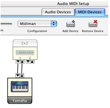

Here is my audio/midi setup from the little app that is in the applications folder and the utilities folder of that "Audio/Midi Setup".
It requires the midiman driver from the CD or website to be installed to 'see' the interface.

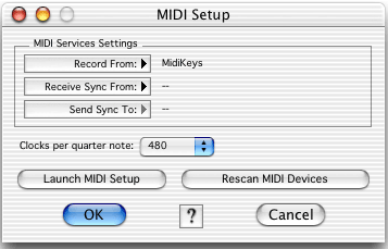

Then in metro go to the setup menu and choose midi setup.
From the popup (where I have midikeys displayed) you will be able to choose your synth by its name in audio/midi setup.

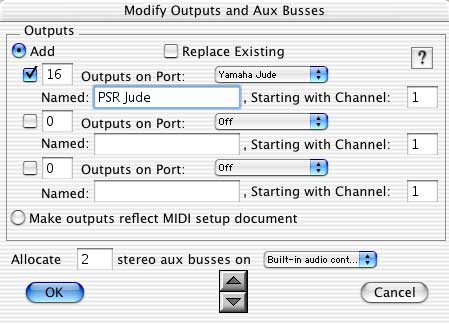

Now go to the special menu and modify outputs and busses.
In the picture below (the popup says DLSMusicDevice) choose your synth.

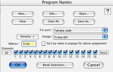

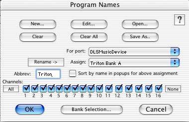

Pick program names from the setup menu - program names
(port again will be synth's name)
If the correct program names have been selected, metro will now correspond to the triton names.

You can choose your port/outputs (which mine says DLSMusicDevice1 and yours will be the output names) and you can choose banks and programs based on which program name set has been loaded.
For your drums make sure you choose synthname-10 as the drums are usually allocated to port-10 otherwise they may play as piano or something.

Yes. You need to attach the devices to your MIDI setup manually. Audio MIDI Setup (AMS) willl not do that for you.
With the MIDIsport never click the reset or rescan buttons as there is a bug in their driver that causes the interface to grey out if you do that. To reset the MIDISport, quit all MIDI applications (e.g. Metro, AMS) and then restart them.

You create outputs on port triton and click ok.

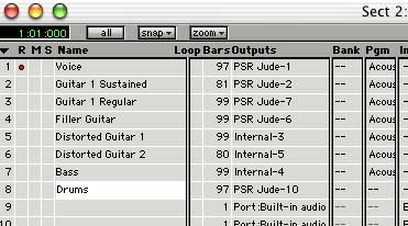

Metro now knows there is another location but the midi tracks are probably still allocated to "internal" and playng the tune will output sounds from the mac's speaker.
Either in the graphic editor or tracks window, change internal-1 to triton-1 etc and all of a sudden metro will play the sound out the synth.

Have you been ticking 'replace existing' in the modify outputs?
I was wondering why you didn't have a set of 16 outputs on the built-in audio port......which I believe is part of metro's standard config.

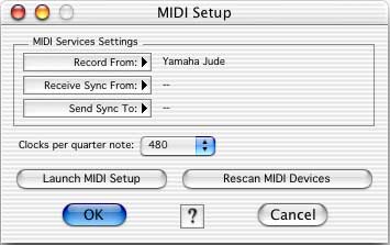

OK. I decided to plug in the midisport and all of a sudden Yamaha and port B were available to metro in the midisetup even without the actual synth connected. This is the midisport and OSX talking to each other. Then I connected the synth to finish the circuit and the midisport 'in' light woke up. The 'out' light only goes on playback.

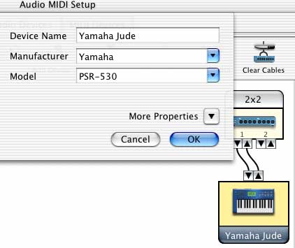

So I thought I would go through the process with my synth renamed with Jude in it.
Doubleclicking on the synth icon in the audio/midi setup and changed device name to Yamaha Jude.
midi setup in metro now can record from Yamaha Jude or Port B.
(port B is generic as it hasn't been configured for anything else).
In modify outputs and busses I have - internal, audio, yamaha jude, port A and port B.
(port A is probably there cause I was in metro previously before I connected the synth. I named the outputs PSR Jude to distinguish them from Yamaha Jude).
Switching the internal outputs over to PSR Jude's and they output to the synth.
As far as the program names go, you have to have a port available/selected and then open up a .ins file or similar which are in the metro folder Program Names & Drum Kits. Here's what it looks like after mytriton.ins was opened.
