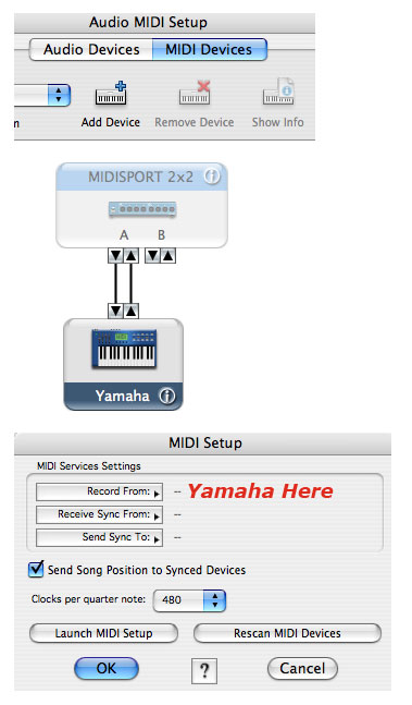

you have gone into applications folder -> utilities folder and opened the litte app called audio/midi setup and configured a synth with in/out connections to your midi hardware that has the correct drivers installed so it can be chosen???
Go to midi setup in the Setup menu and choose your device to use.
In my example I have a midisport USB device and a Yamaha synth.
After you have the ports configured you allocate outputs to the synth in the special menu - modify outputs and busses.
Then its just a matter of choosing a bank and program to hear the correct sounds from the synth.
If you can obtain a list of program names for your device you can install it as a .ins file under the menu option "program names" from setup menu. Once installed save prefs and it will be there next time you start.

Thanks. I had done all of the configurations, ad nauseum. Just to be sure, i retraced steps as you laid them out. Same result. That is, until I added your suggestion to modify the outputs and busses. I had used the Interface (Firefly) and not added the keyboard.
However, I did figure out that in the TRACKS window, I had not added QS7 as an output, there. It had defaulted to either "Port:QS7" or I had set it to Channel 1, 2, etc. It works now that I added QS-7 in the Modify Output and Aux Busses window. What a difference that little designation makes!
