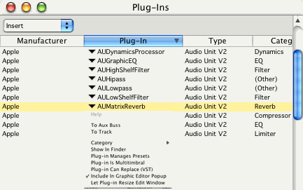

The easiest way to get what you want is to right-click (or ctrl-click) on the plug-in in the plug-ins window and select 'multi-timbral'. Now when you select Kontakt in the tracks or graphic editor windows it will automatically load on an aux buss and will also create 16 MIDI outputs for Kontakt, freely assignable to new tracks.
To get multuple, say 8, outputs working, go to 'modify busses' from the special menu and create 4 (This will give you 8 outputs). Then in the synth/effects window click on the output popups and assign each stereo out to a unqiue (higher numbered) aux buss. You can control the return volumes with aux levels in the mixer window.

That sounds like you have not right-clicked (or ctrl-clicked) on Kontakt in the plug-ins window and selected 'plug-in is multitimbral'. After you do this, selecting Kontakt from the graphic editor or tracks window will load Kontakt on an aux buss, where you can route multiple outputs, and will automatically add 16 outputs to the outputs popup.
