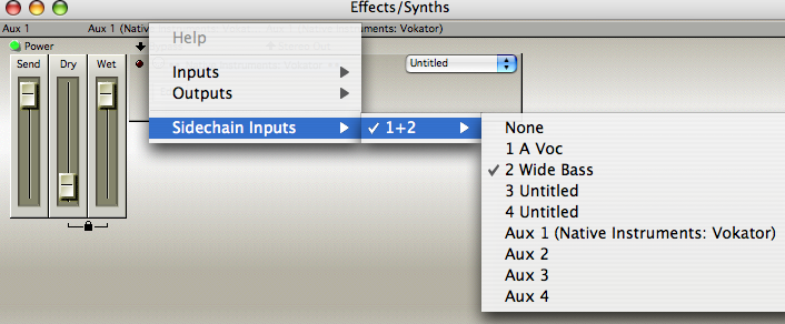

No because it is not a track output. It is related to the effects input. Right now in 6.4 you need to right (or ctrl) click on the effects title bar which brings up a contextual menu that lets you select any of the effects inputs as a sidechain input. If the effect had 4 inputs there would be a second menu item named '3+4' and it would have a submenu with tracks and auxes attached. Here is a picture:
